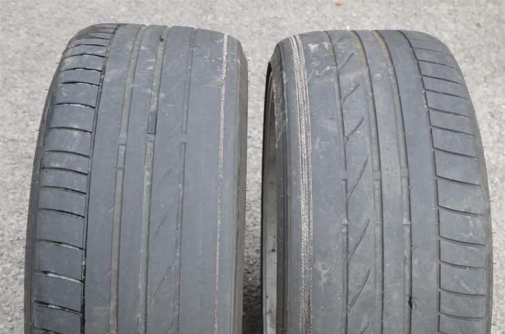

I purchased Cayenne from Porsche Cambridge about three months ago. I made 3000 miles and today I discovered they the rear driver tyre i.e. very worn on the inner edge .
Please, can you let me know what could cause this damage? The rest of the tyre is not worn, just the inner edge.
I would like to know what happened as we would like to avoid the same damage on the new tyre :(

but it is only one tyre ! only 3 - 4 cm rest tyre is like new, second back tyre is like new. Porsche tell me that is my foul because I need check wheels aligment all the time !! :) I have 3 porsche, panamera 4s - a lot problems with breaks, cayenne turbo problems with tyres, 911 4s problem with papers ( I bougt 3 month 911 from porsche Silverston and I dont have log book !! and DVLA tell me that I not owner this car !! I pay and fight. I am very suprise that so poor porsche services :(

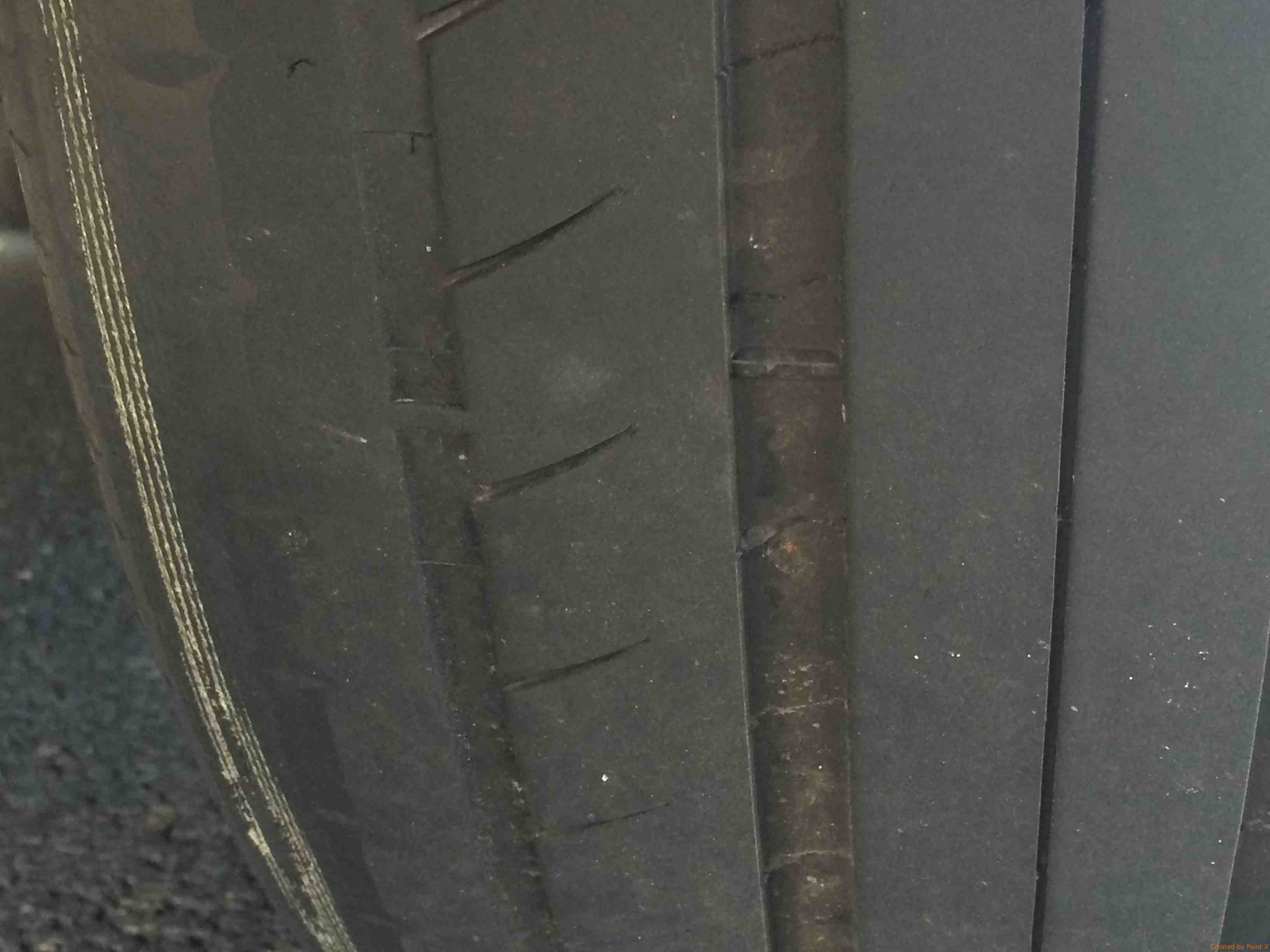

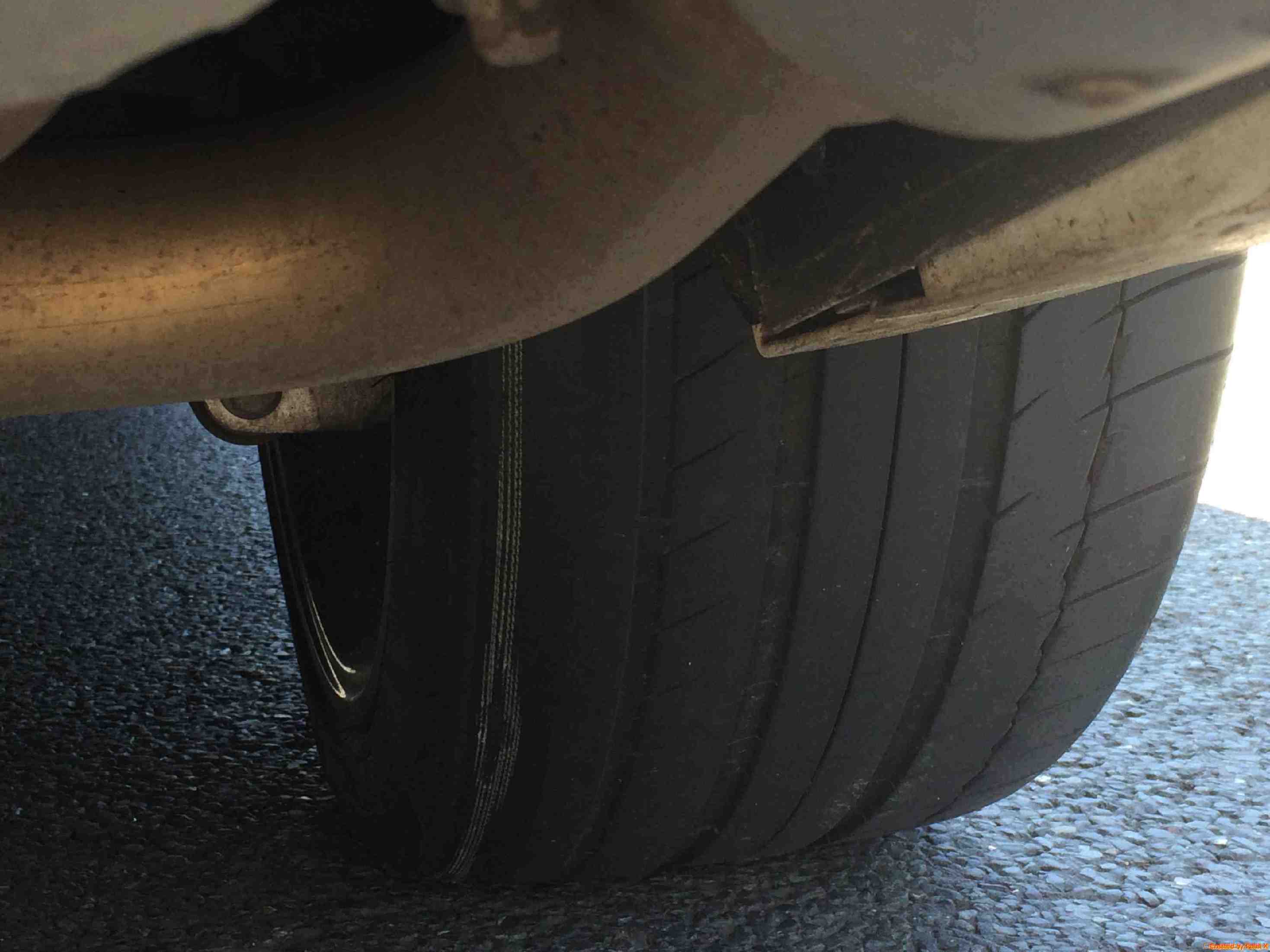

Looks like my fronts.
Front boots worn to canvass​
Too much toe-out, mate. I would imagine the vehicle's hit a pothole or something and pushed the wheel out.
Get your dealer to check and replace any damaged suspension components and give it a full geo alignment. [;)]

I bought this car in 03.2014 from Porsche Cambridge and after one week I change wheels and tyres for winter. Afret one month I change wheels and tyres from winter 20" on summer 21" in Porsche Colchester 2.5 months ago and summer tyres was like new. After about 1000 - 1500 miles one back tyres is like on pictures, second is like new. I will be tomorrow in Porsche services because I think something is wrong with the car and if I have waranty and it is porsche foul why I need pay about £300 for one tyre.
I had BMW X5M, 650Ci and it is normall that back tyres are finish very fast but two tyres look the same.
