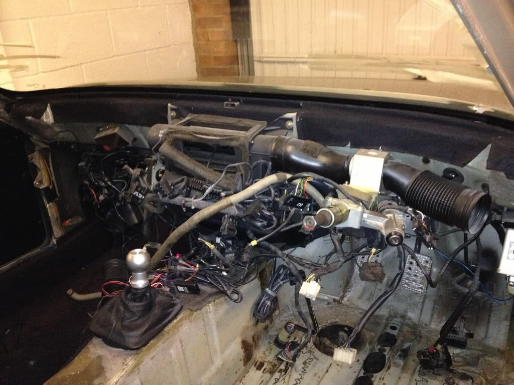

Having spent what felt like an eternity this weekend replacing my very badly cracked dashboard does anyone have any suggestions which could help prevent the same happening to the replacement. Would it be possible to treat the dashboard with anything for instance??
ps, the moment that you get the old dashboard out is quite scary. Talk about daunting! (see pic) [&:]

Thisis a job i have set for myself in the winter and seeing your picture is making me feel quite nervous about it all; do you have any tips?

I've removed and refitted a dash. It looks brutal but isn't too bad provided you have plenty of freezer bags to put the screws in and write on where they came from - take plenty of pics too.
It looks worse with the dash removed:
Compared to 5 mins later with it replaced:
