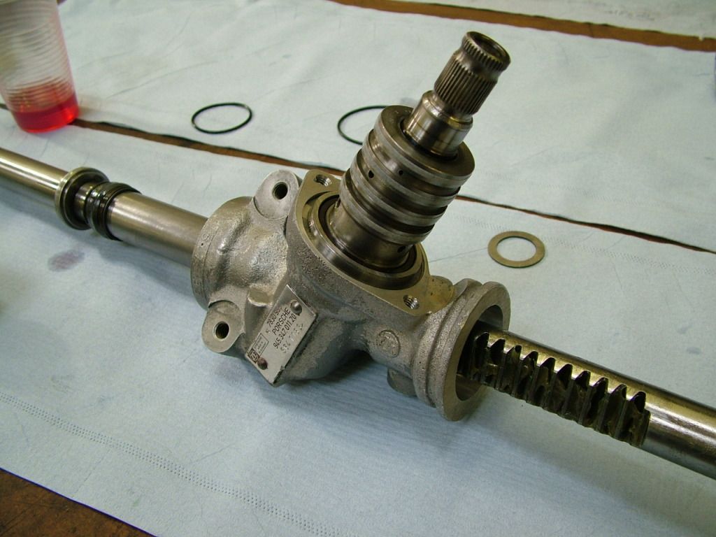

Changing seals is rather easy job to do. When you have rack off the car it is about one evenings job to do for a first timer. Just clean it properly before you start to putting it to parts. Take lot of pictures, so you can be sure new seal goes to right places. If there is wornout metal parts, like toothed saft, no seal kit would give you help.

Of course they can. I did it few years ago. Got parts from my local BMW store. Seals were about 20€
I did mine. US kits are for LHD racks - not all seals are common with RHD.
The key is to find a good quality kit, try here.
Just take your time and be very careful not to damage any of the ground surfaces when removing seals.

Yes mate I have enquired bout shipping a kit from America as they are only $74 USD but then it did dawn on me that it would be left hand drive. Haven't asked about wheter they can supply RHD yet. I might try the BMW E30/E36 route. Funds are limited at the minute due to the engine rebuild and I just can't afford the price that Porsche Shop want for the kit. Failing that given that I now know how easy it is to liberate the rack I may just clean and refit for now. It still works OK but I am convinced that there would be benfit in a refurb.
