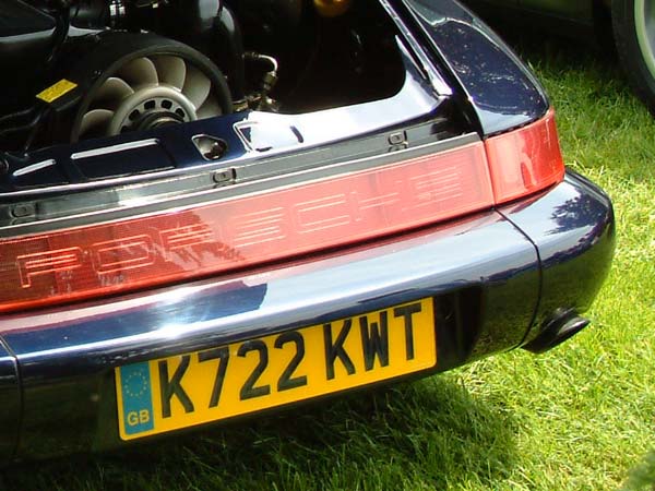

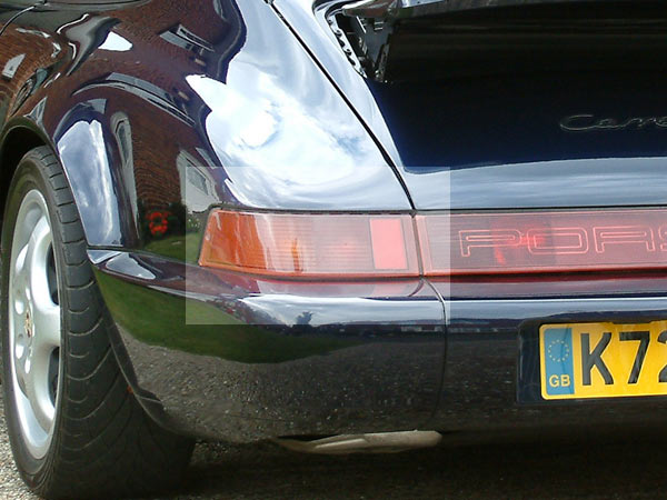

They did look different from light level though, if i remember correctly between the top of the light and the boot lid it looked like a grill afair so you may be able to see if you have old or new fitted.
Mine was a '93 late model revised
Dug thro my pics and found a rear end shot [;)]
You can see the vents here
Thanks Elliot, my lights semm to be a combination of early and late . They have the same look as yours with the cut outs in the black plastic that surrounds the light lense. I also have gaskets fitted as they didn't look right on the SC without them. I think the earlier cars have greater tolerances round panels so the 964 light clusters seemed to have too much space around them.
