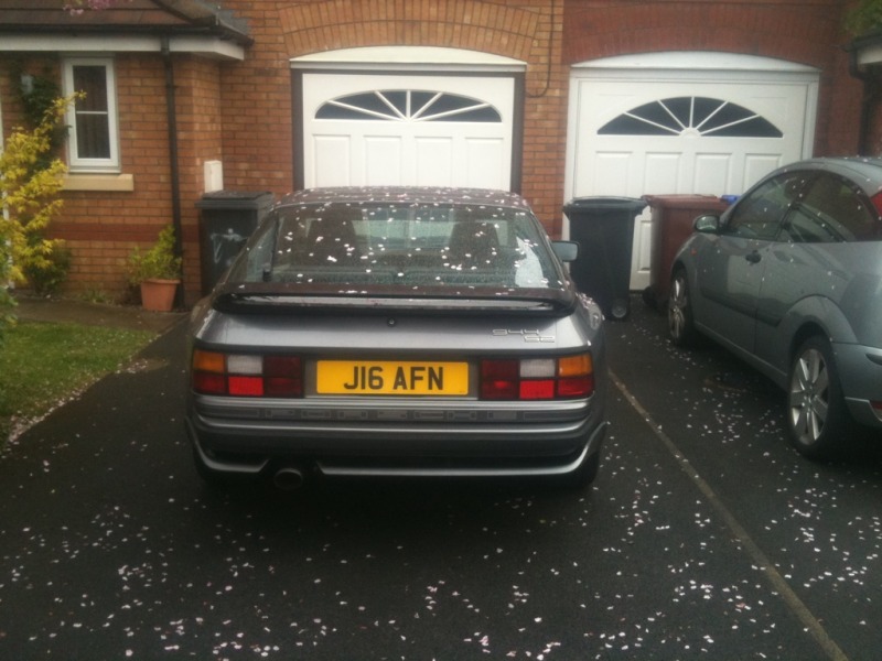

hi I'm a new member and just bought a very late 944 s2 sept 1991 ,having searched for an s2 for some years
Ive had a 944 before and I am generally into classic cars also owning a mr2 mk1 in excellent condition
when I viewed the car the owner picked me up from the local railway station in the car and drove me back to his house
the car seemed good I checked out the coolant,oil ,oil pressure
the car had extensive history,just 100k miles ,5 previous owners and looked in good general condition
titainium in colour ,decent tyres ,virtually new discs and pads and a clean interior
so I bought it !
on the way home i found that the cars cooling fans didnt work ,the car had monumental transmission backlash
and the dampers seemed to be quite worn out ,well it wasnt the end of the world
but the next morning I started the old girl up and I could hear what sounded like piston slap
now I know these are aluminum engines and I'm wondering how common this is ,and if it is bore/piston wear
what to do about it ?
after taking it round to my mates house he thought it was a really beautiful 944 ,and drove it and said the backlash isnt that bad
but then a steel brake pipe burst and I had totally no brakes ;-(
the car is currently in a garage near my friends home having a new brake pipe fitted and they also noticed a bad fuel line
that broke open when it was prodded so theyre being done as well
I called the previous owner and said come on lets be straight ,and he told me they'd got rid of it because his brother
had borrowed it and overheated the engine as it had run low on coolant and up till the mot had no antifreeze in it
I really like the car coming from a newish very boring bmw and being intrested in classic cars but this possible piston slap worries me deeply

The transmission backlash is bad compared to a modern car but compared to one of my mates 924s which is an 's' it is worse but not massively ,in the history for the car (which is very extensive) it says dif/pinion wear from about 50k miles on every report ,I spoke to the previous owner to the one I bought it off and he had the car for quite a while and said it was the same then ,he also asked how the car was looking as he really liked the car when in his possesion and he'd spent a small fortune on it
AFN (Archie Fraser Nash) were the original Porsche concessionaire and they were eventually bought by Porsche. The AFN dealerships are still operating as OPCs now, owned directly by Porsche Cars GB.
the cars history ,low owners ,lowish mileage at just 100k ,and the extensive history is what attracted me to this car ,I think I did pay too much but ive looked at cars double
what I paid for this and theyve been in worse condition ,the AFN link also contributed to my deciesion
