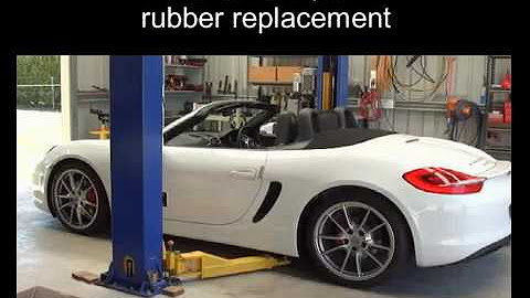

On YouTube, I found an Ausie who has vids on every job on a 981 including the auto box fluid change.
It was his vids that enabled me to fix my non-operating soft-top for £90 as opposed to Porsche doing the job for £900, it was just a faulty microswitch but needed the hood removing in order to replacing the faulty one, and removing the soft-top is not difficult once this chap's video is watched.
