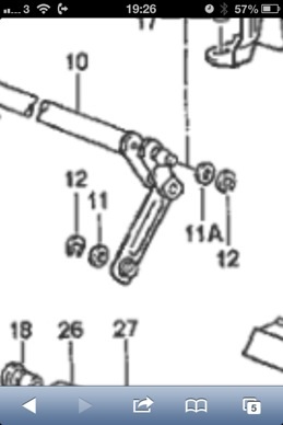

Can you identify he part from this
Not sure which bit you mean. If you are after parts then download a copy of PET appropriate for your car from here
http://www.porsche.com/uk/accessoriesandservice/classic/genuineparts/originalpartscatalogue/
then look in section 806 ("Concealing Headlamps") to identify the part. Phone your local Porsche centre tomorrow with the number and ask them.

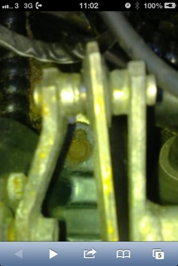

So it's not this broken washer then because when I sit it properly its fine no adjustment is needed
But obviously when lights pop up and down its not sat there right
Try cycling the lights up and down and then adjusting whichever is too low with the method I described. If it works it's cost you nothing and if it hasn't then it's cost you nothing :)
If they both sit evenly low it is far more likely to be the limit switch on the motor or even the mountings or the motor.
If the lights rise a bit further before retracting it is the limit switch, if not look at the motor mountings. If its neither of those the motor spindle may be out by one spline.

Iv read this before and understand it fully but the washer gromit thingy what joins it all together Is broken which is letting the link bar rattle out of place resulting in a low light on one side
