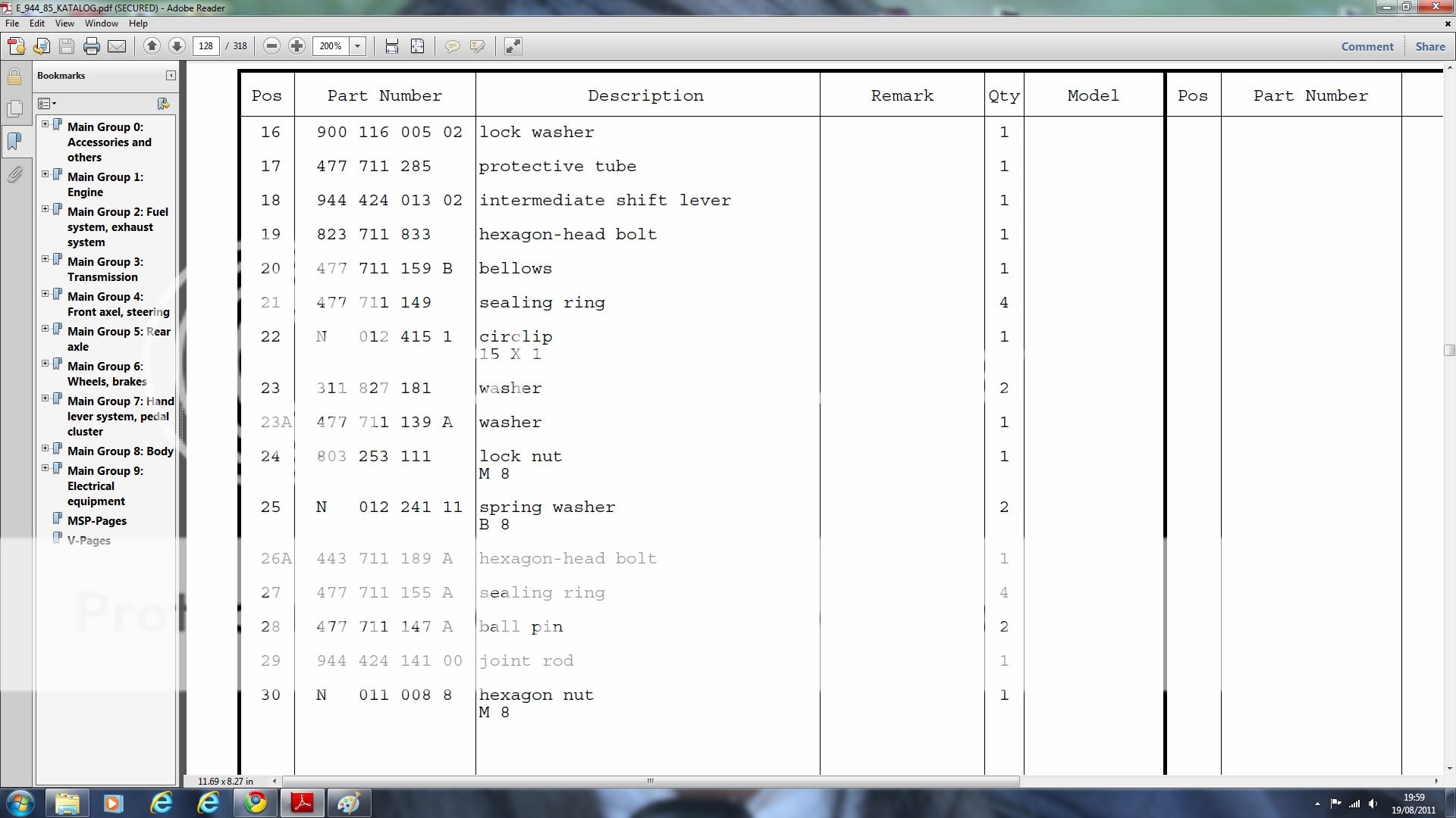

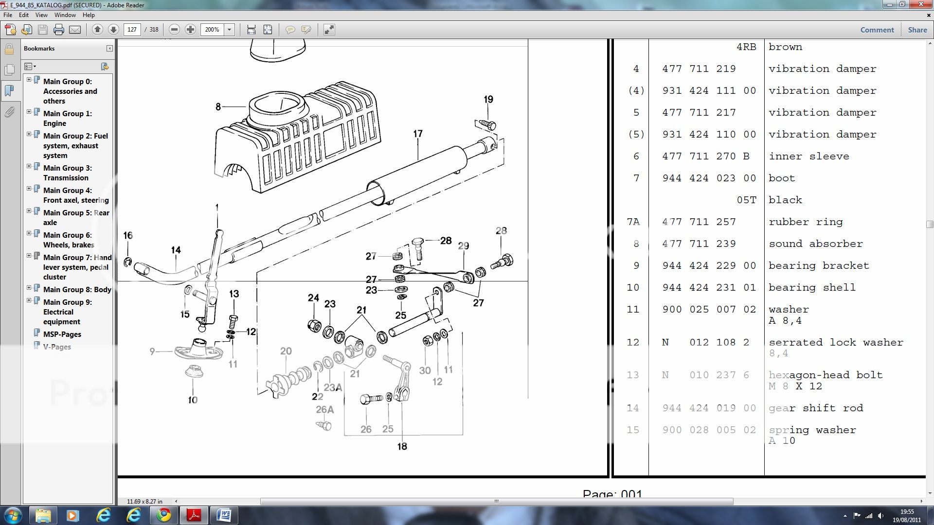

Yea it is [&:] (I spent ages last night printing out each of the transmission pages to take down to my garage so he could show me exactly which parts I needed - I felt a right berk when he looked through them all and said 'this is all automatic!') Specifically I'm needing pics of the gearbox linkage and part numbers that goes to the top of the gearbox (several 'knuckles' I believe) - this is to fix a very waggly gear stick! Already tried replacing the joint rod but to no joy. I've emailed OPC again and they've agreed to take screenshot and send me, but I'm not sure he knew what I was on about. Really need to get this ordered today though you see. Otherwise it's very handy to have genearlly as I'm always needing little bits here and there. (Aren't we all!) Thanks so far Simon!

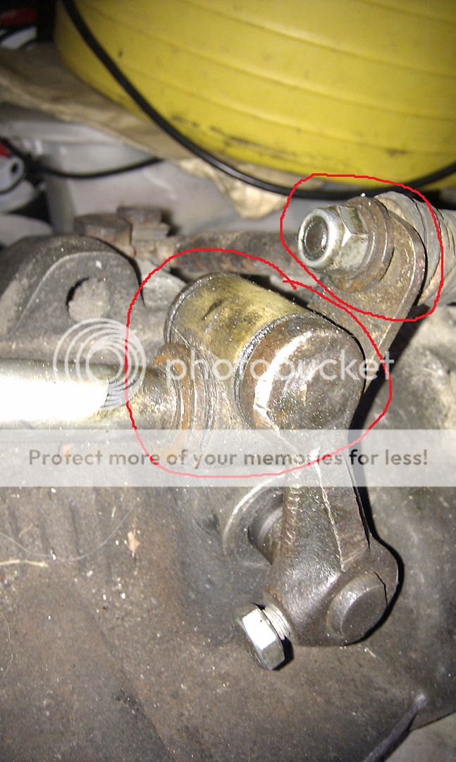

Hi Outrun I have one for the early car, manual trans (know its early car - 2 gearbox mounts) if you have a"proper" email address NB all the 'boxes have the same linkage I have a 'box in the garage
The usual problem with the sloppy change is wear in the plastic bit, ringed in the centre of the pic. The other ring is around the adjuster - just put it n the middle not like this is!
Had a play!
The plastic cross bit is not numbered, its between the 4 number 21s Hope this helps ( can send the full PET still if you want)
Mike you're an absolute star and diamond!! Thank you so much, especially taking the time to take pics, edit and upload - I'm sure we'll meet one day and I'll be buying you a few pints!! I guess the question really is then whether the OPC will sell the 'plastic bit' on its own or all the bits of that section (including the "intermediate shift lever") as one part - I'll get an answer Monday from them I'm sure. I suppose it might be better to get all the bits, although I'm not sure what my garage is expecting me to get for them. Many thanks, Al ps .... I do have the same PDF but was looking in the "Main Group 3 : Transmission" section and didn't realise/think that this would be in the "Hand lever system" section!! Well ... I suppose when you think about it the name does give it away somewhat! Hand lever system? Errmm GEARSTICK please!! haha!
I don't think the plastic bit is available on its own as it has no part no. It is possible to shim the holes (Ali drinks can!) as a temp repair. Also if you can't get piece of can in, the problem is not there. I found (twice) that the horizontal shaft on the hand lever gets badly worn and is the main offender.

You have checked the easy bits first haven't youo? Part 10 above is a major culprit for a "waggely" stick, breaks up under Part 9 and the broken parts just sit there and stick becomes very loose. And that part will cost you under £4 (if they try to charge you more phone Newcastle OPC!) Change that, check that there isn't excessive wear on the pin that goes through the linkage and if its still loose you know its the main linkage bush and you've only spent £4 and half an hour to be sure you need to spend more
Any chance of driving it down to Leicester? I've had a bit of experience with the gearbox and linkage. One I improved by taking some trapped foam from under the hand lever mount! The main problems are the horizontal bush and balljoint on the hand lever and the plastic cross bit.
