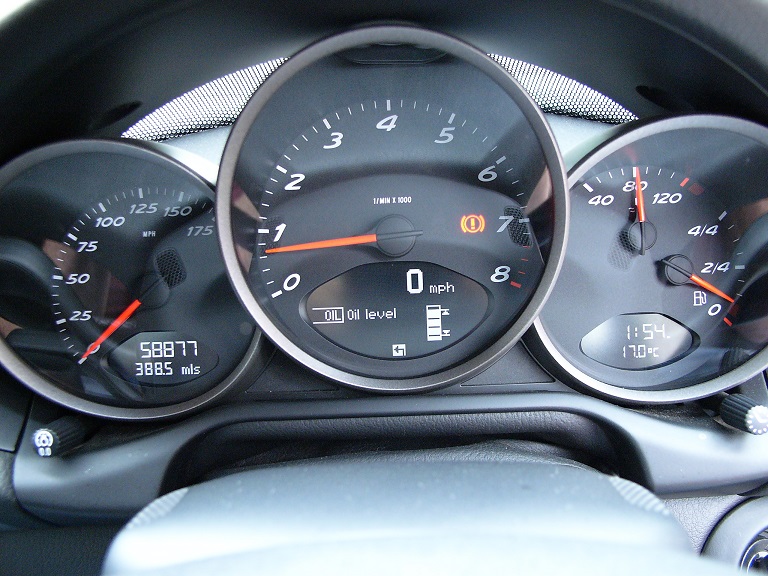

If the sump is very full of oil then when the engine is stopped some oil will puddle in the bottom of every bore, maybe some more than others and this hot oil will rest against the lower ring.
If this oil can get past then you have oil ready to burn white (smoke).
