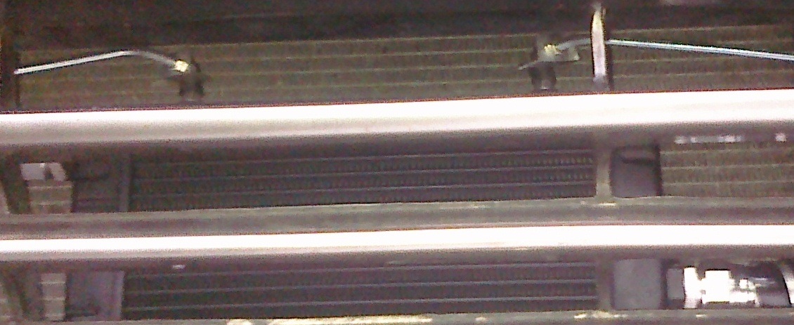

Hopefully the picture is embedded ?
Anyhow, 13row in-line oil cooler fitted in series with the existing 951 cooler. Bottom mount = aluminium u cross section rail with rubber m6 bobbins, top mounts, rubber bobbins and m6 threaded rod fitting into existing A/C matrix mounts.
I've run it up in the garage, all OK, just need to road test it !
Hopefully this should keep the oil below 100C whilst at the ring in July
