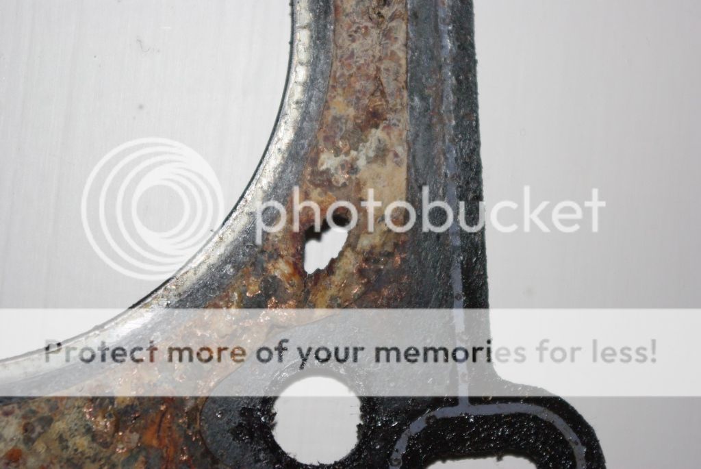

I am just taking apart an old engine 2.5 N/A - 160k + which I know has had the cambelt go at some point, whether it had a new gasket at that time I don't know - the engine was running fine with no obvious problems, and the engine was not swapped with any thoughts about the gasket.
As can been seen the gasket has holes in 3 places allowing coolant through were it shouldn't!
So I certainly think that a close eye should be looking for possible signs.
