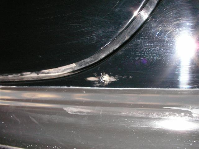

The front RHS inner wheel arch where the oil pipes turn down to go under the RH sill had an accumulation of dirt and the underseal had cracked. I pulled the loose underseal off and cleaned it all up and there is no corrosion there, just brown staining. The LH headlamp bowl has been repaired and has fresh (ish) underseal there. The doorshuts are immaculate and the kidney bowls seem fine. However, the LHS sill cover has trapped dirt against the sill and there is some flaky rust behind the sill cover, at the bottom of the 'B' pillar
I gave it a good prodding with a screwdriver and although the rust is flaky, the metal wasn't crumbly and was solid underneath as far as I could tell. I didn't get chance to take any photos, so I nabbed one from another post elsewhere :
There are 4 blisters in total on the car, 2 on the LHS side, one where the pic's is, the other below it, just above the top of the sill cover. Another blister is on the RHS side, same place as in the pic. The 4th blister is on the LH rear wing, above the wing/bumper join. All classic places where these cars go. Each blister is literally half the size of my little finger nail, but I know they are just the tip of the iceberg.
