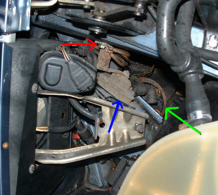

It took me 10 minutes to find the horn which is buried beneath the passenger headlight. There are apparently two on the S2 although I could only barely see the edge of one horn. (green arrow) The blue arrow is the temporary horn I fitted from a mondeo and the red arrow is the earthing point which was severly corroded
I managed with great difficulty to remove the two electrical connectors and when the rubber insulating covers were removed the terminals were revealed covered in rust and very corroded. The horns are unfortunately placed directly beneath the passenger headlight so that every time the headlights are on and it rains you have water pouring over the horn and connectors.
