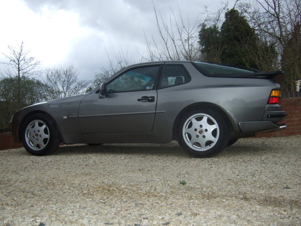

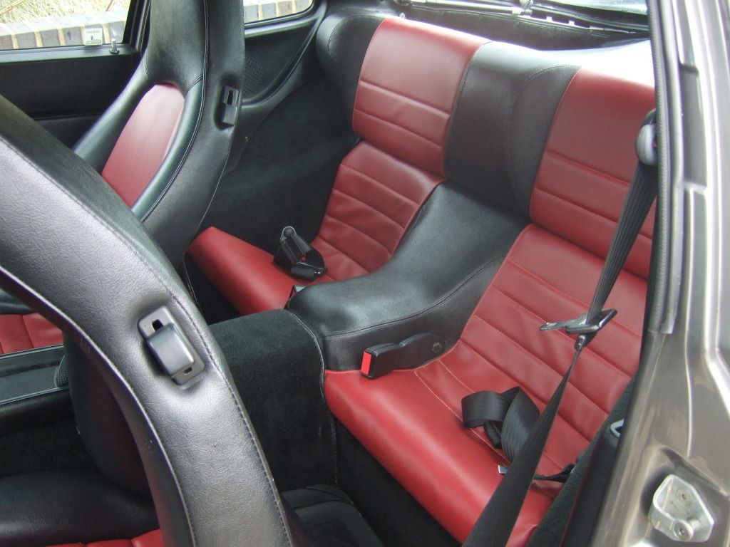

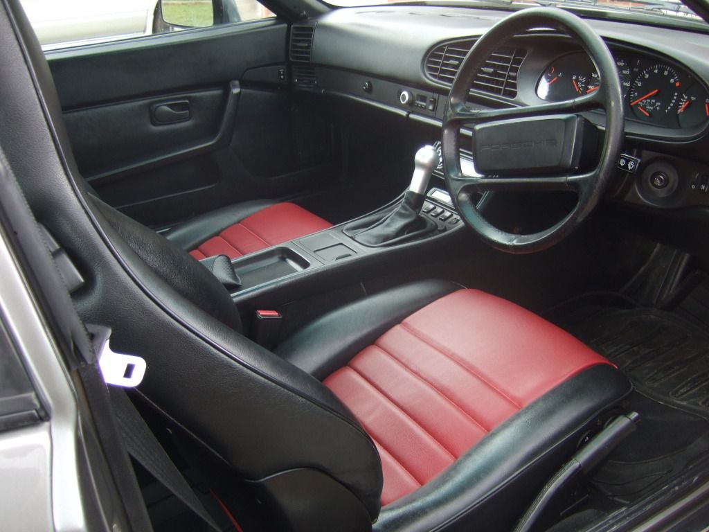

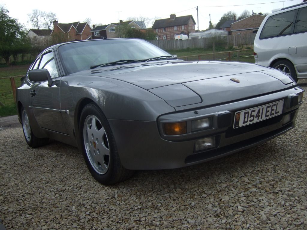

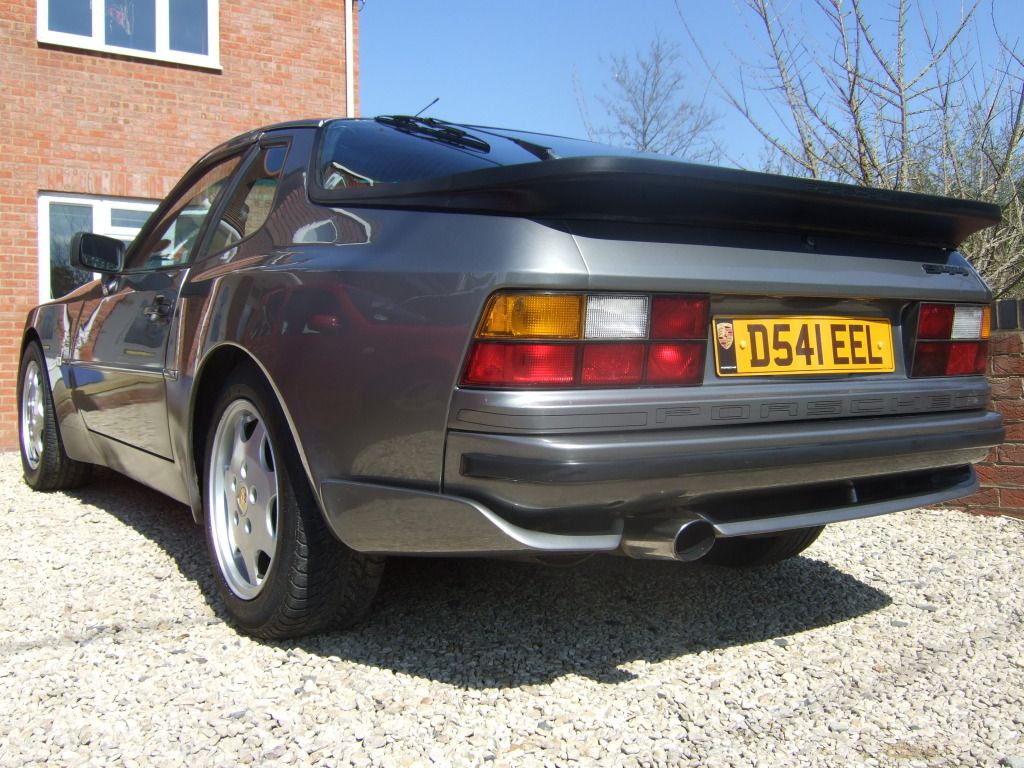

Thanks for all the great advice guys, looks like I will have a busy weekend sorting those bits out, but that's the fun of running an older car[:)] I have found my camera lead now and uploaded some photos of my car, not sure if this is the right place for them (let me know if they should go elsewhere)
Well, copying the image code from Photobucket doesn't work then, what is best way to post photo's on the forum?
Looks very smart - red seats dont usually do anything for me but theres not too much and the overall effect is great.

Mark, Part of your problem with the automatic gearbox display may be because you have a non-standard gear change - from your photograph you have a ball at the top of your gearchange with a push button on the top. The standatd automatic gearchage is a T shaped handle with the button nearest the driver for operation by the drivers thumb. The assembly at the bottom of the gear lever may have been altered to fit your top assembly. The diagram in the Porsche parts catalogue - PET - may allow you to compare your set up with the standard set up. Mike White 2.7 automatic

ORIGINAL: Dockrell Mark, Part of your problem with the automatic gearbox display may be because you have a non-standard gear change - from your photograph you have a ball at the top of your gearchange with a push button on the top. The standatd automatic gearchage is a T shaped handle with the button nearest the driver for operation by the drivers thumb. The assembly at the bottom of the gear lever may have been altered to fit your top assembly. The diagram in the Porsche parts catalogue - PET - may allow you to compare your set up with the standard set up. Mike White 2.7 automatic
I thought the gear selecter looked after market, I will have to get it out and do a little investigating and see whats going on underneath. Forgive my stupid question, where would I get a 'PET' from (what does it stand for?) is a parts catalouge for the 944? Any recomendations for parts suppliers would be great.
