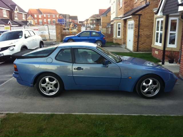

It's a 1986 LUX 2.5. Will this be 21 gallons then? So assuming I drive sensibly I should get 38mpg that would give 700 - 800 miles per tank.

If the car has an oval dash it will have the larger (plastic) tank, if it has the square dash it will have the smaller steel tank. An '86 can be either!
Edit - I've just looked at the pic and you appear to have rhd wipers, so you will have the oval dash and thus the larger tank. Early or square dash cars can only have "lhd" wipers.
