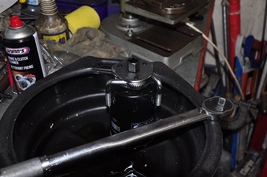

Used my latest filter removing tool, what a brilliant bit of kit; no more bashing a large screw driver through the can.

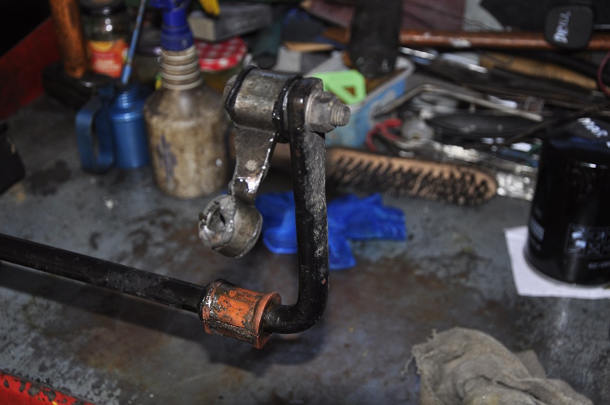

That all done, and time for the roll bar bushes, the ones that push onto the ball pins in the rear arms.
This will be my 3rd set since I've had the car, and to me can be 'one-of-those-jobs' where you wonder what Porsche was thinking with the design.
Getting the drop links off the arms was easy. Heat then to near melting point and a pry bar makes easy work of them.
Took the roll bar off to remove the drop links, check he bar and bushes and get ready for the fight that came along doing those acetal cup bushes...
New bushes to hand and the first bush was a pig to get in (as usual). Got it nice and warm but what a game as it refused to slip in evenly, but won the day in the end.
Discovered I had put the bush in from the wrong side...but the drop link was ok for the other side of the car! Whew.
Getting the drop link onto the ball was again the usual fight but after about 12 attempts it slid onto the ball. All a matter of balancing forces in play.
The other side took 5 minutes! All fell into place first time....
