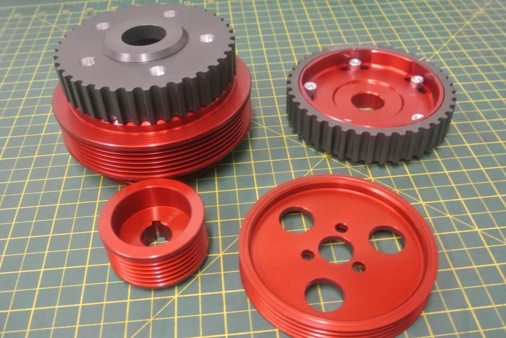

Some pulleys I made for my 944. can't wait to get them on.
after removing mine, I found some of the plastic pulleys were very worn... I have had these hard anodized,. and they wont wear like the standard ones,. plus I made the cam pulley adjustable for fine tuning. still to finish off the rest...
Also made the power steering pulley the multi vee type as the belts are easier to replace plus, meant i could get the crank pulley lighter
