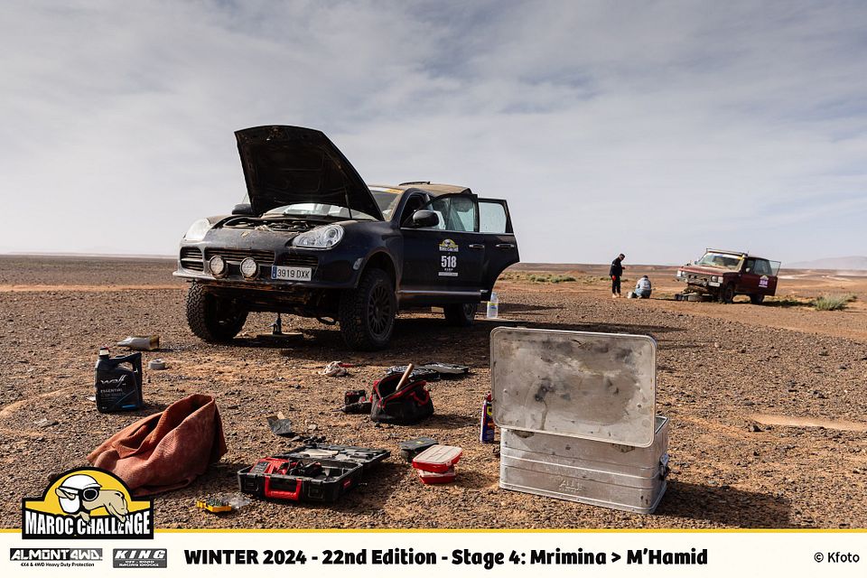

I'm doing it, I also did it last year - it was me/my Cayenne in the article.

3.6L V6 is by far the best option, the V8 cars have the oil filter in an exposed position which even with a sump guard can still fail due to compression of the filter housing against the sump. They're also a little heavier and a little less durable than the VR6 but more importantly VW parts are most available in Africa than Porsche parts!
V8 cars with springs are also quite rare, you really want coil spring suspension for this as it allows easy conversion to something like GMC suspension which is a must for ride height, compliance and durability.
Having done this last year when there was a V8 Cayenne and a V6 Cayenne (mine) competing in the same event we had opportunity to back to back the performance. The V8 was no quicker across ground but unfortuntately smashed the oil filter on stage 4 and retired accordingly. The V6 went to the end.... and drove back to the UK!
