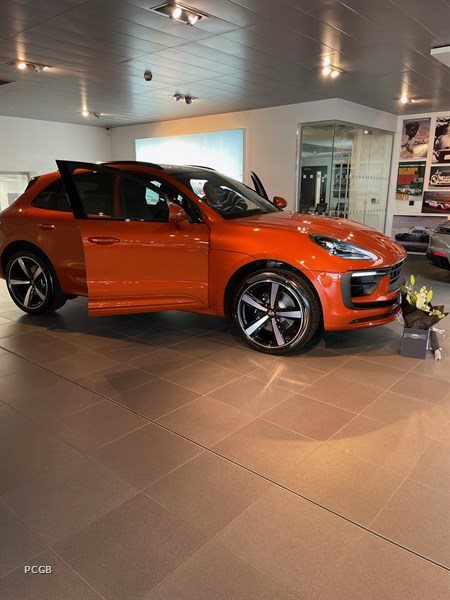

My current Macan S II came with 19-Inch Macan Turbo Wheels which are very functional but I feel 20 or 21's would look much better. On the Porsche accessories website the only wheel offered is the 21" RS Spyder Design wheel which is nice but I personally prefer the Porsche Macan Turbo IV 21" but wheel choice directly from Porsche seems to be very constrained.
On the Porsche website it appears 20" or 21" must only be fitted "Only in conjunction with wheel arch cover (part number 95B04480005)". Has anyone had these fitted retrospectively? Are they really essential? Presumably it is related to the rear wheel offset.
Does anyone on the forum have advice for switching to 20 or 21". Does the car need to be recalibrated in any way? What would I need to be aware of regarding TPM sensors. The car does have air suspension.
Thanks.
Tim.
