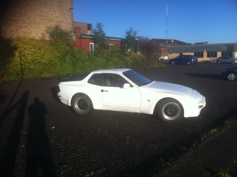

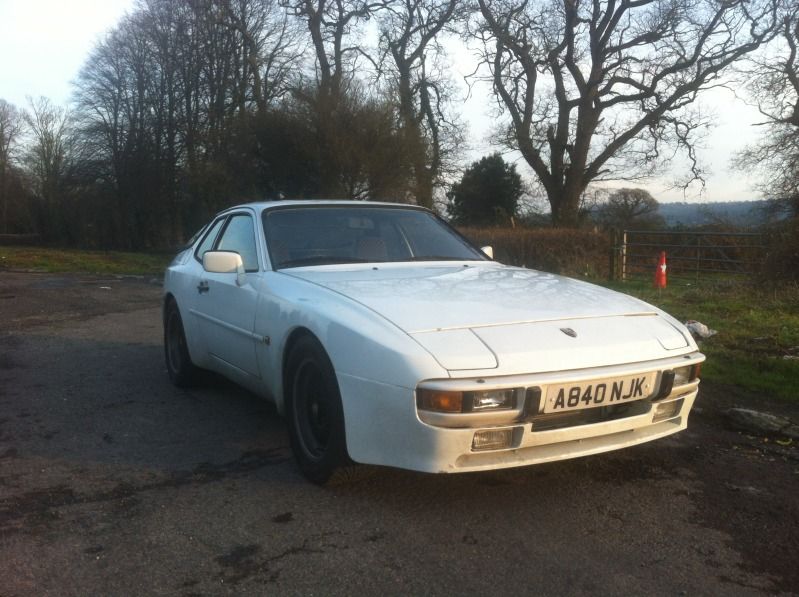

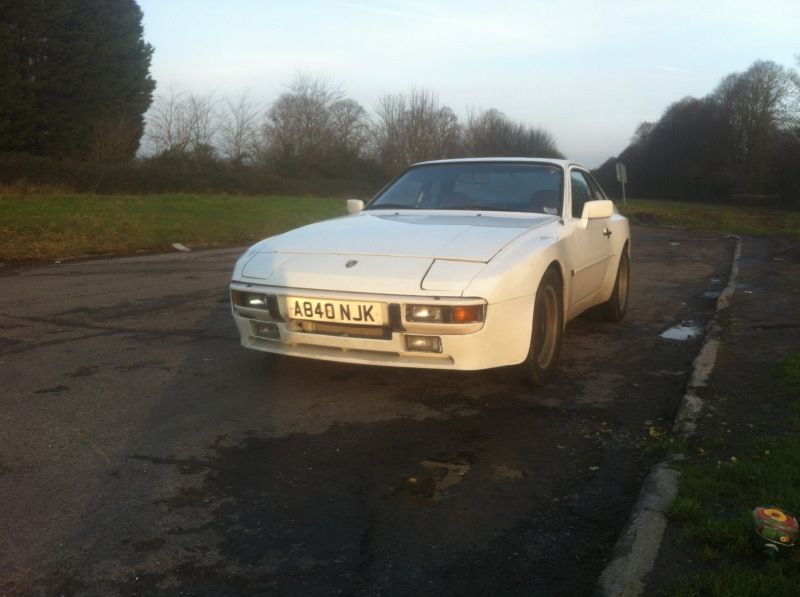

Ash, there's a bit of discussion about this on other threads here as well. The best bet is to upload your pictures to a photo hosting website (I use photobucket.com - it's free) and then put links to them on here, as I have. 'Quote' this post and you'll see the tags to make it happen.
Nice looking car. An early one, so light and with the more nimble suspension. If I was ever to change my S2 for another 944 I would be choosing one of those.

I thought I'd start by buying older hoping on moving up in a few year
it's a bit tatty needs a bit of loving but I'm hoping I can get it looking the part again
