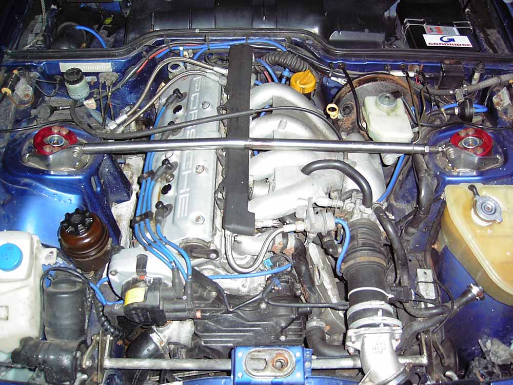

If you look at the pic ive attatched, [ Yes its a S2 engine bay, but they are almost identical.] In the top LEFT hand corner, youl see the clutch reservior. The other side of the small bulkhead that the res is bolted to, is a black cannister with a vaccuum pipe attatched, just in front of this is a cable with a connection the +ve terminal to connect the jump leads etc to.. Remove the cover of the cable [there is a joint in the cable],,+ connect up. Making sure you make an earth connection on the engine block....
I had to do this when i locked the boot on my cabrio.. And theres no way of getting into the boot of a cab without power....[8|][8|][8|].
I hope you get sorted out..
