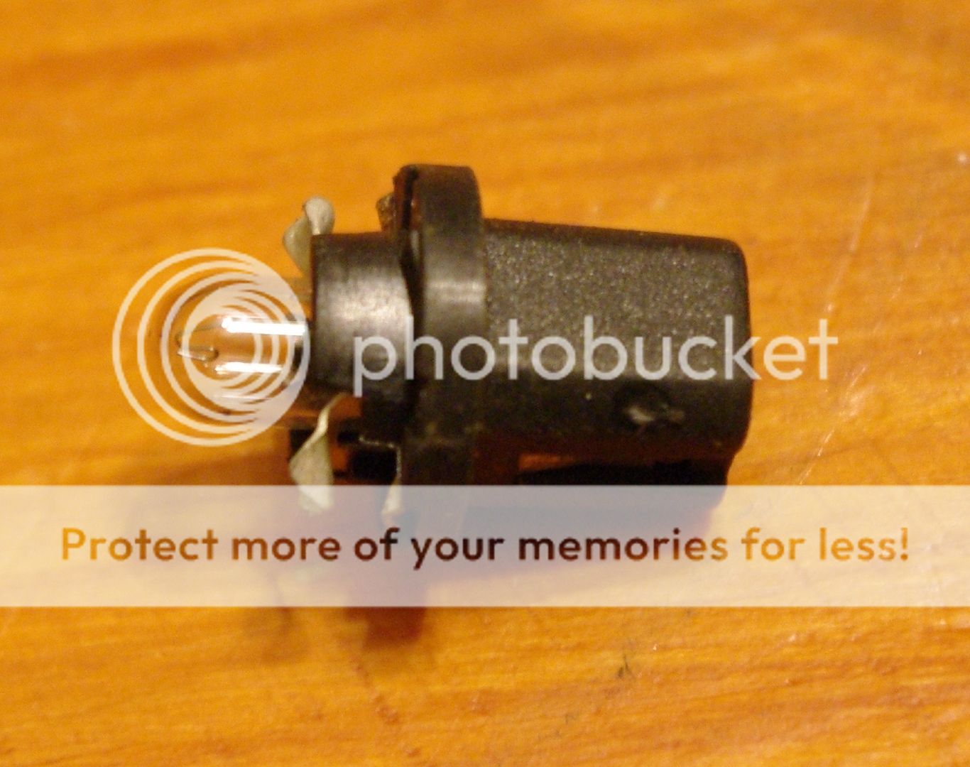

Checked earlier but I haven't got any spares. They are 1.2w and are mounted in plastic bayonet mounts which push and twist into the circuit board, with the contacts on the top (bulb end) of the mount.
Hope that helps!

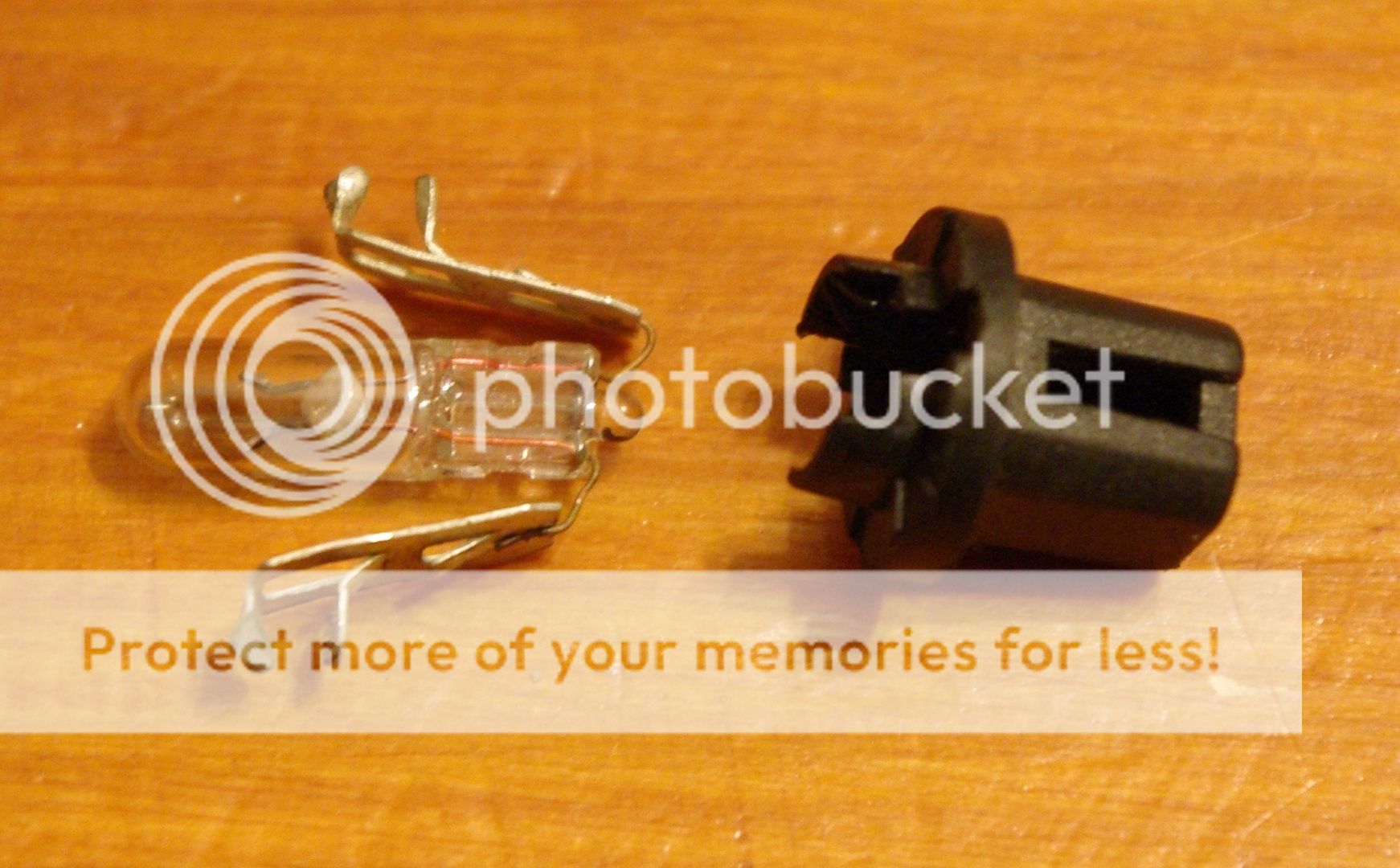

Found one - whilst looking for something entirely different!
They come apart easily - the legs are soldered to the contacts but would be easy to replace with LEDs
Thanks for the pic Mike. Looks like they're the same as for my MK1 Golf, in which case I have some new ones lurking in the garage![:D]
