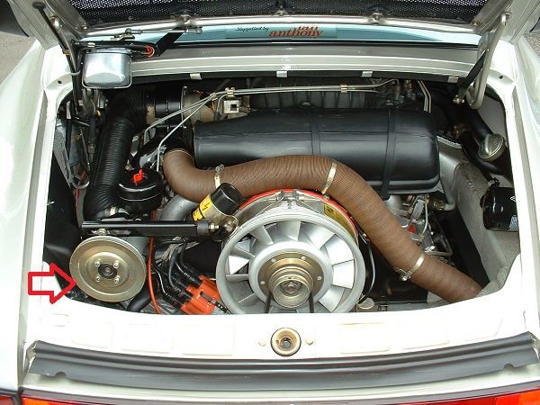

PS - Very tidy engine compartment with no air pump present - it would normally be taking up a big bit of space between the distributor and the LHS engine mounting, but you can see the casting for the two bolts for the mounting bracket on the timing chain cover.
There is no air pump fitted to your car.
This would have been fitted to the left of the main fan (as on my previous SC above) and used the additional drive on the outside of the fan pulley. Bely removed on my car to give additional bhp.
Sadly sold my SC some year ago with the pump still fitted.
You car looks beautiful by the way.

Thanks so much Peter. Great photo explaining where the air pump sits. Read somewhere that these were sometimes removed as it gives an extra few bhp. What did it do? And many thanks for the compliment. Scarlett as she's affectionately known will be chuffed to bits :)
The pump was driven by a belt from the crankshaft pulley and was designed to inject air into the exhaust gases in an attempt to meet emissions regulations by providing fresh air as a source of oxygen in the exhaust port to assist with combustion of any un-burnt hydrocarbons. Adding fresh air to the exhaust gases also gave the impression that the emissions were diluted and therefore somehow less - A Neanderthal version of VW's "cheat" software many years later.....
The "additional" bhp referred to will basically be those saved by the engine not having to power the air pump.
Many owners removed the drive belt (as in Peter's picture), but through time most removed the whole pump to also save some weight. When doing this, the pipework on the bottom of the engine into the exhaust ports should be removed too and the injector holes plugged with grub screws.
