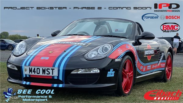

Since then I may been on Multiple Cannon Runs and this has given me the confidence to do more things to the car...as you can see in the Picture at the end of August the car went off to S6 Wraps in Essex to be half wrapped with Martini Racing Livery and the Wheels / Callipers painted Red. This was Phase 1 of Project Boxster.
Project Boxster - Phase 2
For the last few months I have spent a long time looking at all of the different performance and tuning options that can be done to my 2.9 Boxster and after speaking to a few manufacturers for clarity especially IPD I put together my stage 2 package. My friends at Bee Cool Performance and Motorsport in Kettering are going to put it all together and then do a remap on the car to finish it off.
Here are the components for Phase 2
Lowering Springs
Eibach Pro-Kit 30MM Drop - E10-72-006-01-22
Air Filter
BMC Airfilter - FB416/16
Headers / High-Flow Cats
Topgear PORSCHE 987.2 CAYMAN BOXSTER MANIFOLDS & CATS (200 Cell Sports Cats) - 108012
Intake
INTAKE PLENUM COMPETITION + THROTTLE BODY PORSCHE 987 CAYMAN/BOXSTER S 3.4L DFI IPD - IPDKIT98734
1 x Aluminum Intake Plenum - Competition. Porsche 987 Cayman/Boxster S 3.4L DFI IPD (87482)
1 x Throttle Body 82mm for Porsche (99760511601/1)
As the car is now 8 years old who knows how much the car is making BHP wise it could still be making 256BHP or less, although it had no problems beating a 220BHP VXR on my last airfield run [:D]
My research tells me that the car should be able to make roughly 295 BHP once all fitted and dialed in.
Paid for the components yesterday and the car goes in on the 5th October and I'll have her back on the 11th October so i'm pretty excited.

The General Public do seem to like the Colour Combination, had nothing but positive comments on the car
Here's how the car looks now complete
