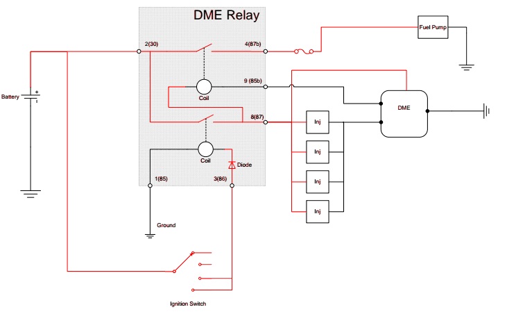

Hi everybody.
I have a 944, registered June 1982.
Most of the circuit diagrams, seem to start from 1983 onwards, mainly 1985 on.
Knitting them together, can be a bit awkward. Non seem to exactly relate to what I have in the car.
I have asked around, amongst those that may be supposed to know but nothing productive apart from the usual advice that you should carry a spare relay or such like.
Now, I know that 'modern' electronics, even in 1982 were more sophisticated than in earlier times. But, in those days, there was always some one who could say, "Hang on, I'll draw you a circuit diagram of just that section, so you can trace the fault"
That way, you could follow it along until you found the problem. There is no basic reason why you could not do that today. Without replacing various parts in guesswork to see if that sorts it.
From my present experience, there does not seem to be anyone out there that has that ability and gift of knowledge to do so.
Or, can you prove me wrong ? Meanwhile, I shall labour on and shall eventually 'produce it myself'. Surely, that should not be necessary, I have other things to work on. I'll finish the cills on the 924S. And may be scrap another 944 !
