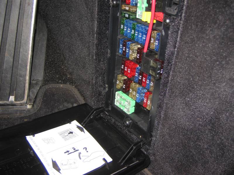

Hi. I have done this for my camera detector I went to halfords an brought a Normal looking fuse but it has a wire coming off it I did I by trial and error but you will find a switchable empty fuse in the fuse box 997 gen 1 is drivers side by your right foot
You don't want to do it like the photo above, because the wire won't be fused!

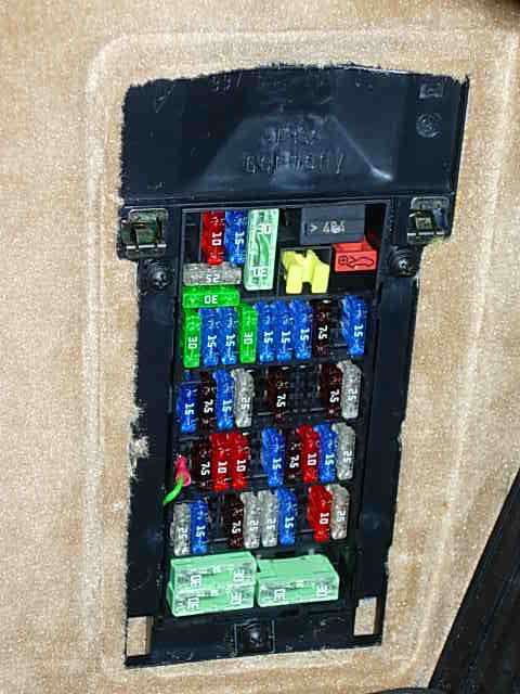

Like Darren, I used a fuse tap:
Thanks for the tip. The wired fuse seems to be the better way as it will be reversible and hopefully I can hide the lead under the carpet. Incidentally I did ask the Porsche main dealer about this issue when I bought the car three years ago and they couldn't help.
