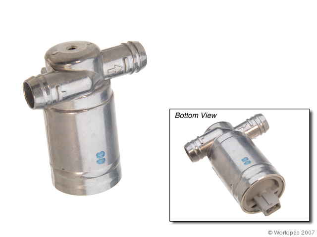

hi charles heres a pic of the valve for you ..its near the front under the inlet manifold..hope this helps you out..
