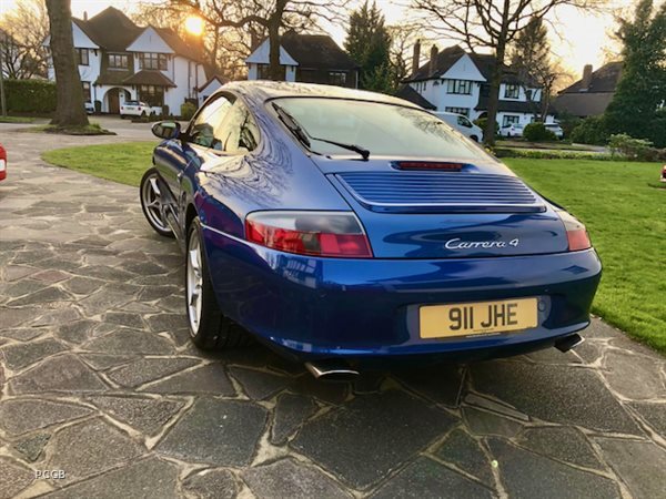

[attachImg]https://www.porscheclubgb.com/forum/download.axd?file=0;1106822&where=message&f=IMG_6100.jpeg[/attachImg]
Great pics, looks lovely in that colour
