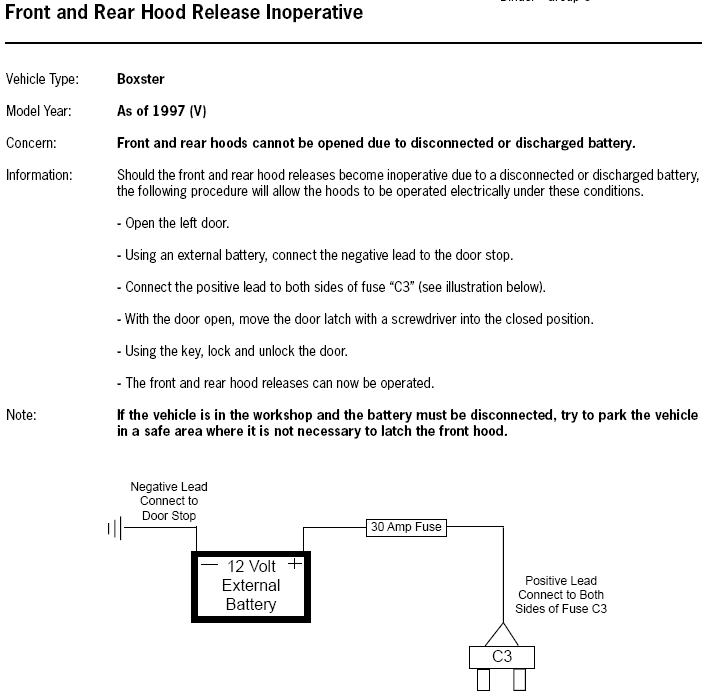

2. Under the fuse cover (where the spoiler switch is in the drivers footwell) is a piece of paper with instructions on what to do.
Basically, use jump cables to connect neg to the door catch striker on the drivers door aperture, and the positive to the special terminal that pulls out from the fuse box.

The Boxster has a minor difficulty. If you have the alarm and the battery goes dead, you cannot open the front trunk to get to the battery to jump start it. There have been three techniques discussed for entering the front trunk when this problem manifests itself.
- There is a Porsche Technical Bulletin describing one way that works for entering the car. See Front and Rear Hood Release Inoperative [grp5 1-96 5510 1-21-97]. A description of what one owner did to construct the device mentioned in the bulletin is shown at http://grr.xoc.net/boxster/articles/dooropener.asp

I'll also try the electrical method in the bulletin, but not sure how you connect a jumper to both sides of C3 fuse as its embedded in the panel.

Cars after MY01 had electric release buttons for the boot lids in the drivers door sill, prior to this they were mechanical levers which lock with the central locking - if your battery ran flat with the car locked these will still be locked.
With the electric releases came a battery jumper/terminal point in the fuse box (drivers footwell) - connect a second battery to this and an earth point to pop the boots. There should be instructions on the fuse panel cover in the driver's footwell.
