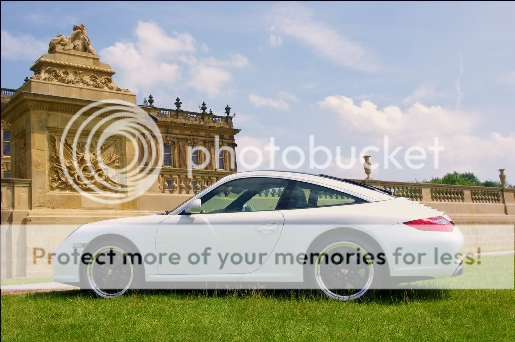

Having said all that, a friend had some of the new 19" Fuchs on his 997 Targa, which did look really good
