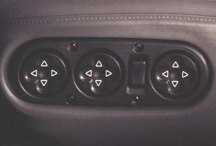

Anyone got a photograph of the switches for the Porsche heated seat options for a 993?

They are on the side of the seat with the other controls. From a practical point of view they would be better somewhere you could see them!
