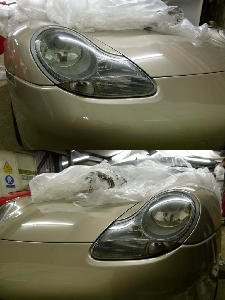

The loud crack is part of the process. The noise confirms that the headlamp unit has been disengaged. Continuing to turn the handle will lift the unit slightly and push it forward out of the wing (don't worry, it only moves slightly forward - not so far that the unit will fall out). Wheh the unit has been disengaged, turn the handle back through a quarter turn (this will position the locking bar ready to receive the unit when refitting). Check the female electrical fitting before refitting - it has a tendancy to work loose and sometimes needs to be repositioned so it's firm in its housing.ORIGINAL: Richard Hamilton
You have to unscrew and pull at the same time. When you get them off you will see the rubber bungs behind the liner. They just pull out. Follow the instructions in the manual carefully, as it will make getting the lights back in much easier. Don't be alarmed by the loud 'crack' when you turn the tool to release and tighten the light unit - "they all do that"!

Anyone done it?.
Davedavies
It makes the light nor natural and they look well.
The only advice I could give is to be very carefull if trying to force out larger pieces of the filter that you dont bend or damage the outer casing where the bulb holder fits.
I slightly deformed one of mine and moisture could get in and create condensation in the lamp.
A hot air gun easily straightened the housing and all is well again.
I tihnk the website says to use a soldering iron to melt and deform the filter prior to removal, this is a good idea as they do take some breaking when cold.
Also if you break them inside the housing, you can get small pieces of amber plastic loose in the lamp that can be difficult to remove.
I will try to get a picture of the lamp with it removed and post later today.
Dave
