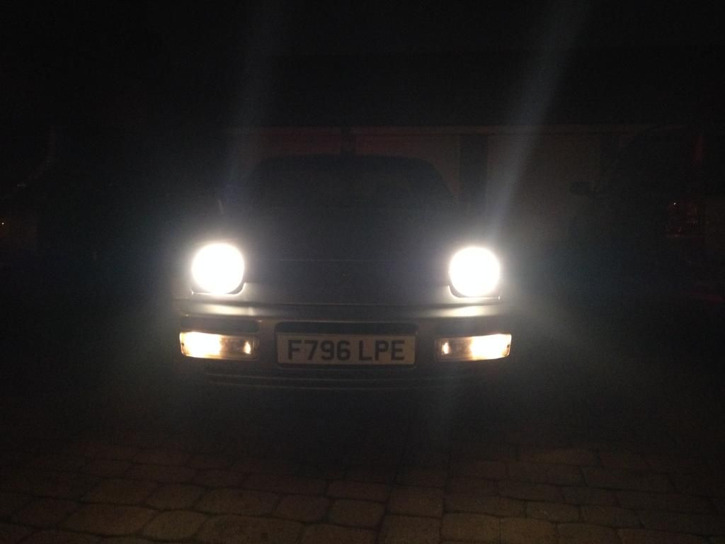

I was off ebay last year, bought it for myt mk2 golf but never fitted it so put it on the 44 last week all I can tell ya is its a 8000k 35w kit

The colour temp is ridiculous though! Id guess that something closer to 4000 degrees kelvin is ideal - they will look purple! Anything over 5000k (cool light) is blueish.
its not as bad as it looks its a mobile photo and the light I the garage wasn't bright enough to fade the camera

ORIGINAL: johnboytaz its not as bad as it looks its a mobile photo and the light I the garage wasn't bright enough to fade the camera
It looks sort-of alright. My comment was based solely on the stated colour temperature, which is really blue.
