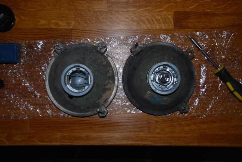

Bert, At the risk of sounding disagreeable (and hence with apologies), I've discovered that you are half-right. Yes, o/s and n/s are the same (checked a VW parts catalogue), but Mk2 Golf lights don't fit straight into a late 944.
Note the position of the tabs on the Golf (left) and 944 (right) parts. I think the lower tab is in the same place, but the upper two are closer together on the Golf part (neither are in the same position as on the 944). Options are to move the tabs or swap the glasses over. I'm going to try the latter, as the Golf reflector also has a hole in it for the sidelight, which the 944 one doesn't. Anyone have any suggestions on how to do this? I seem to recall reading once that the glue is thermoplastic, so will heat it up in a hot oven and see what happens ... Wish me luck. Oli.
Bert, OK, that wasn't clear from your post. Thanks for your input anyway - the fact that the n/s and o/s headlights are the same was helpful. I ended up swapping the glass from the Golf unit to the 944 one, and it was surprisingly easy! I've done a "Technical Article" about it, here: http://www.porscheclubgbforum.com/tm.asp?m=676223&mpage=1&key=&#676223 Oli.
