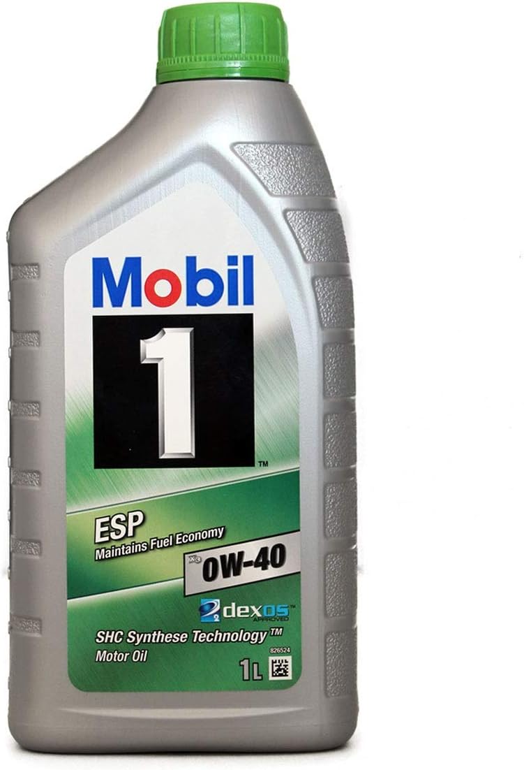

What's the difference between the green and gold label? The 0-40 Mobil 1 I use in my 3.4 has a gold label. Thanks in advance.
I believe it's a slightly different spec oil because of the OPF filters in the 4.0 cars. From Mobil's site:

Mobil 1™ ESP X3 0W-40[/h1] Advanced Full Synthetic Engine Oil[/h2]
Mobil 1™ ESP X3 0W-40 is an advanced full synthetic engine oil specifically designed to provide outstanding performance for high powered engines, providing outstanding engine cleanliness, wear protection, strong durability and advanced fuel economy*. Mobil 1 ESP X3 0W-40 is our latest technology developed in cooperation with Porsche, one of our key European Original Equipment Manufacturers (OEMs). Mobil 1 ESP X3 0W-40 has been expertly engineered to help prolong the life in new emerging gasoline powered European vehicles.

Thank you for this post, we just assumed we could use the same oil as in the 981 and 718 GTS 2.5 l turbo. Though we would have checked the manual before pouring that in. 😅
My understanding was/is that you 'can use either' of the aforementioned Mobil 1 oils, FS or ESP?
Not on my 718 GT4 you can't. The handbook specifies Porsche C40 oil, which is ESP. The FS is Porsche A40.

The manual for our Cayman GTS 4.0 also says to use Porsche C40 oil, here is a screen shot from the Good to Know app:
