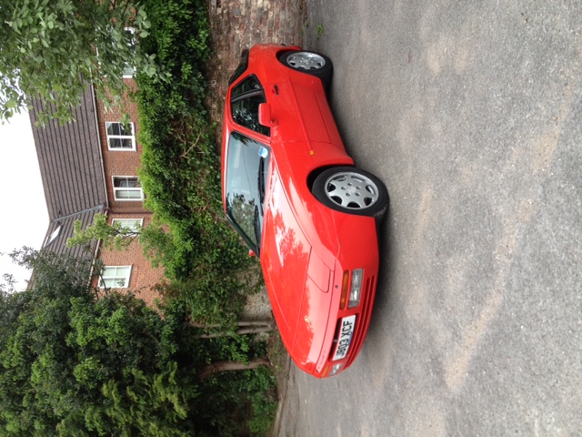

Evening all, after 5 months, just got around to starting work on my S2. It has been laid up over the winter and I am undertaking a front brake caliper rebuild. Any advice on removing pistons and the little screws holding the plates would be appreciated!!
