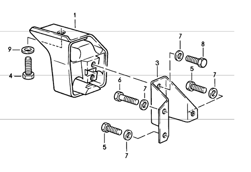

Definitely check the gearchange linkage at the gearstick and the selector on the transaxle. As for the slop you may do well to check your transaxle hanger. It's the rubber mount that connects the transaxle to it's upper cross member. The cross member bolts to the chassis and the transaxle essentially hangs loose on the rubber mount. I was amazed how much movement there actually is in the gearbox [&:]
The early cars (pre 85.5) have two hangars and the crossmember is part of the body structure.
Worth a check, as Rob says, I have seen the central rubber piece de-laminate from the outer steel housing on several different cars.
You are quite right mate my schoolboy error for not checking the vintage but the priciple is still sound [:)]
with pictures!!!....you guys are Porschipedia! (That's referring to the knowledge base... not touching Porsches in inappropriate ways....although?!.... [:-] )
cheers for the advice... I'll check my rubbers!!
