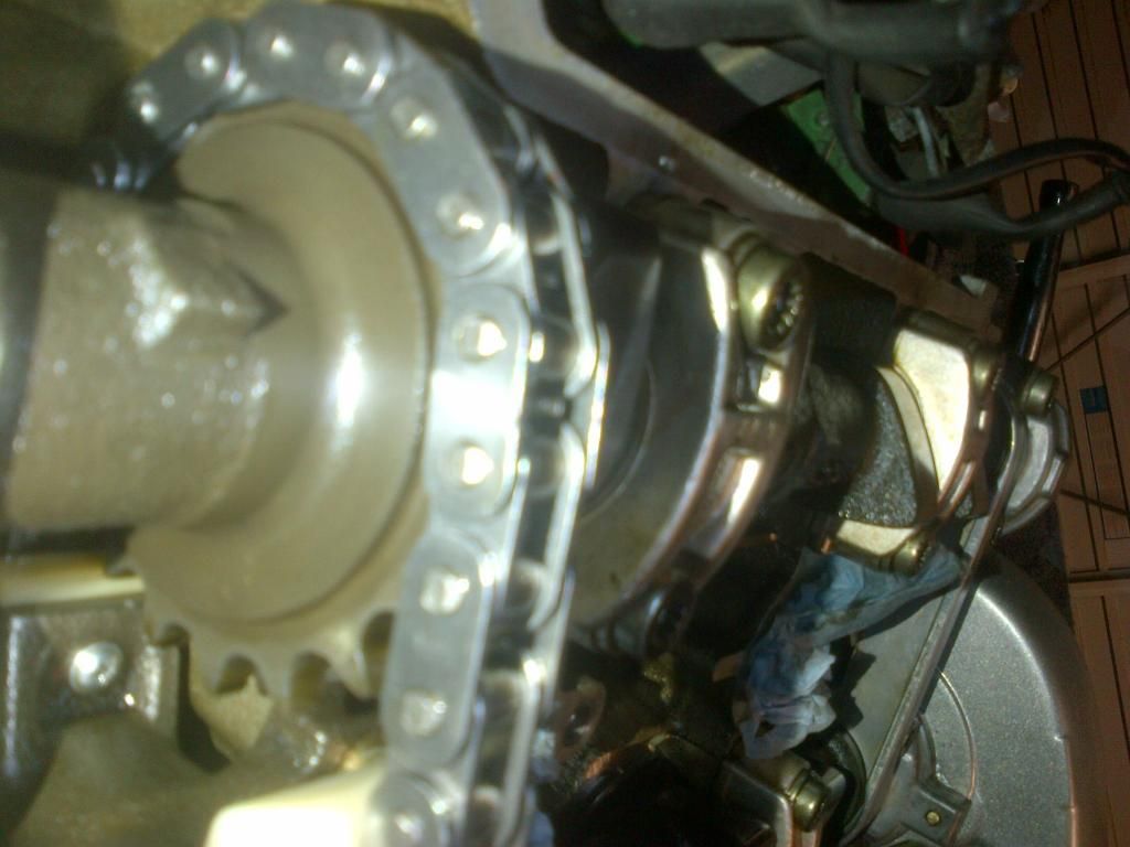

I think I've put my cams in out by 1 tooth! Not turned the engine yet so should be no damage, just annoying!
There should be 7 chain links between the cast marks on the cams according to the workshop manual, and should measure approx 113mm between the two cast marks (I measured 116mm).
The new chain didn't have gold links on it so I've put white marks on (obscured a bit by the camera flash, but where the flash is, that's where the mark is).
What do you guys think?
Exhaust cam: (looks OK)
Intake cam: (looks 1 tooth out to me)

Rob, I have not done a 16v so am useless to advise you, but I agree the photo looks to be 1 pitch out and the diagram is quite clear how it should be.

doesn't look right to me. The one on the left looks one tooth out in an anti-clock wise direction.It needs to go one tooth clock wise.
Thanks guys, that's what I thought. Hopefully I can get away with just taking the exhaust camshaft out a bit. The crankshaft is 45 degrees before TDC so should be ok. I just have to get that blasted front bridge off after loctiting it on again!
OK, got it sorted now... took the tensioner and exhaust cam out, moved the chain along a link and it lines up perfectly now!
