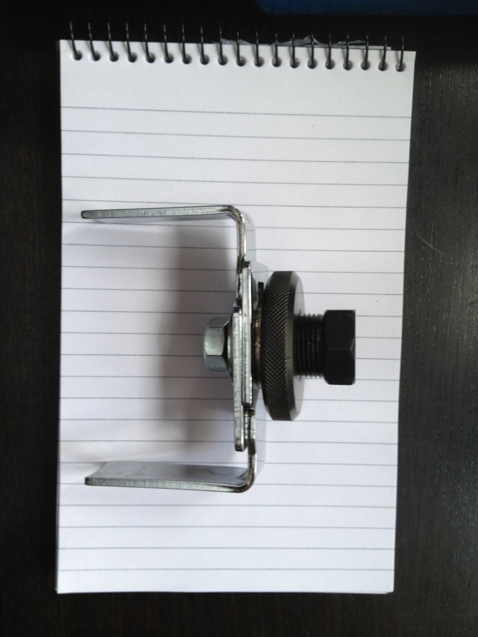

This is the tool I used - worked perfectly. The lugs are 20mm. I got the kit version for about £30, but I guess anything (ie not with a kit) with 20mm lugs would be just as good (and cheaper).
