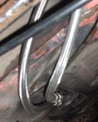

I recently used PTFE lined braided hose to replace my rotten fuel lines above the rear beam, and they've been fine, even used with compression joints onto the existing pipework, sorry for the poor pic;
I also used Heldite jointing compound and so far so good. No leaks on the joints, didn't have to drop the rear beam to post the lines over the top. Total cost of having the hoses made up with all the compression fittings was about £70.
Justin.
