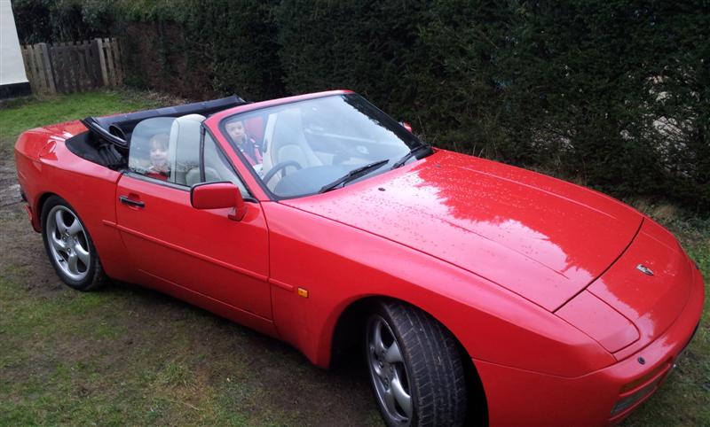

So, I'm now on my 2nd 944! Pre-empting the inevitable bombardment, here she is, a 1990 S2 Cabriolet, PX'd for my similarly Guards Red 1983 Lux coupé.
If I'd got anything else, then my two sons would have complained vociferously! I always wanted a cabrio, but it was the coupé convinced me that a 944 can be the perfect family car! Well, I can't think of many others that are proper sports cars to make me grin on the commute, but can still fit four at the weekend. Admittedly, squeezing child seats in required significant "adjustments", as I hadn't anticipated the lower roof line of the soft-top and how it folds. Still, two happy children as you can see and it passed the rigourous Missus NCAP test.
Coming straight from using the 2.5l 8v Lux as a daily driver, to the 3.0l 16v S2, I'm in a position to compare the models, and I have to say the latter feels much more modern. I was expecting an evolution, but it feels completely different "" much smoother and fair chunk faster! The older model did feel a bit more chuckable although, surprisingly, seems to have had less grip. Also grew to love the retro interior "" the latter seems a bit more plasticcy and dull.
Sorry, now for the ostensible point of the post; I've always imagined having a set of Fuchs if I ever had a Porsche, so now that I'm probably here to stay, anyone have some and want to do a swap for some fairly new Porsche Cup 3s? Ideally somewhere near Hampshire for logistical reasons?!

Not sure what tyres, but better grip on the cabrio may be down to the 18" Cup 3s? Ride is rock hard mind you - I don't mind at all, but suspect passengers do! Not noticed any flex so far, but certainly feels noticeably heavier than the '83 coupé.

Car looks lovely! Will have a cab one day.

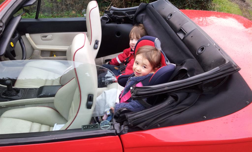

off topic tho, what child seats are you using in the rear?
i have a 2 year old, and another due in august so 2 kiddie seats are needed for the back.
ta for the reply in advance.
Al.

Child seats in a Cabrio - not easy!! Especially if you're married to someone who works in paediatric, paliative care! In the coupe, I bought two non-reclining Nania child seats (similar to Pampero's from Halfords) but one went up to 18kg (for the younger one who's now nearly two) and the other up to 36 kg (for the elder who is now four). To get them to fit in the sculpted rear bucket seats I had to remove some extraneous plastic. I ignored the seatbelts which didn't secure them sufficiently and instead used high-rated luggage straps which hook to a retaining hook in the boot, through the gap in the folding seats, through the back of the child seat and then back to the hook. It was sufficiently tight that I could not move the seat with all my strength and the fact that it was held fast against the seat back meant that they also had sufficient leg room.
The space in the cabrio is similar and there is still the retaining hook in the boot. What I did not realise is that if you try to fold the hood, it will foul the top of the car seats. For one of the car seats I removed the headrest, which was too high for the younger anyway. Even then the roof would not fold, so I had to put a spacer between the back of the child seat and the car to push the seat forward. The result is secure, but I am concerned he'll grow out of it in a year.
For the elder, there was no way I could get his seat in, in a way that we were comfortable with. He's legally old enough for a booster now, but there are only lap belts in the cabriolet. In any case, we think he's too young to move away from the 5-point style harnesses. My solution was to primarily rely on the lap belt, but also add the straps from the old car seat to harness his upper body. I removed the straps and screwed them to the back of the folding section of the seat. The clip is attached to the lapbelt, essentially creating a 6-point harness. You can just see the red straps in the pic attached. It's a massive improvement on normal seat belts, so I'm quite pleased with it and, as you can see, so's Felix!
Hope that helps, but appreciate, it's not going to be a solution for everyone!
