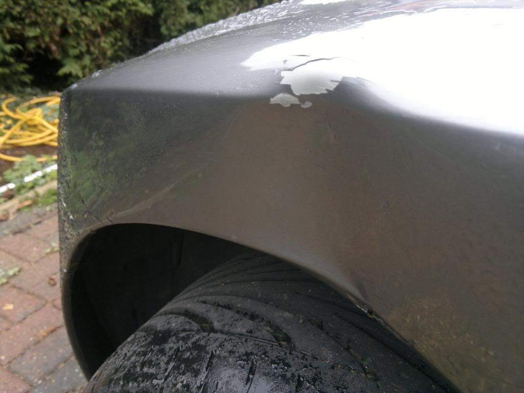

A low loader lorry just caught my front wing when reversing round a bend, I beep my horn, but it was to late. Colistion happened.

The wings are genuine Porsche wings and where replaced 6 years ago so are rust free.
Rather then dent not pulled out and filled. How much off the car would require paint work after a replacment wing?

it was hit with the plasctic part off the bumper so the black may come off but i dont think the dent will push out well anoth

That looks a reasonably straightforward and simple repair if they pull out the dent, a light skim of filler and then the side of the wing and the front bumper will need paint. As long as they don't put paint on the top of the wing or where it meets the door they will not need to blend onto the bonnet or door. One proviso is to watch the panel gap between the wing and the bonnet, it's pushed in by the headlamp at the moment.
If they replace the wing they will also need to spray the bonnet, front door, bumper, badge panel and headlight covers.

You cannot repair a dent of any size without using filler. There is nothing wrong with using filler to finish a repair. People seem to be scared of filler but it's only bad if it is used badly.Any professional body shop will use filler but usually only a very light skim.
Don't worry about filler worry about how good a body shop it is that is doing the repair and how good they are at matching paint.

That has shifted the wing on it's mounts, look at the shut lines with regards to the door and headlight, i would tread carefully with an unknown repairing the car, i know it sounds negative bit if they arse it up you will be back and forwards with the car trying to get a satisfactory repair, why should you put yourself out by piddling about with insurance swaps ?

So Iv been 2 both body shops, my choice the larger set up,
£250 pull the dent and paint. But filler will be used
The place the other guy sent me, £380+ vat 2 pull and body file the dent no filler used. Plus extra £200 if the bonnet needs painting.

WTF is a body file???????
I think someone is pulling your plonker...........
I'll bet you they will use filler or stopper.
The metal in your wing is 0.8 mm thick ......... how much can you "file" out of that?
That's what I asked, but both places said with new wing costing £700 even the insurance would want the dent pulled and filled.
I think I will let them have a go and will try and check up on the work b4 paint. If its not right I will refuse.
Go and check before they put paint on it. They will have to use some kind of filler,but I wouldn't worry about that I would concentrate on the shut lines and the line of the wing when they have pulled the dent. I had a wing with a dent in that part and it's a lot of work to get it right again.The front of the wing at that point curves in several different directions.

Well, mine looked like this and got approval for a new wing...not as bad as yours?

Yes you are absolutely right and my wing had only been fitted 10 months before [:(]. My denting was a bit more extreme than yours and Mcnulters, and we tried hard to panel beat the general shape back into the wing once it was off the car but these Porsche wings are made of mighty stern metal and it resisted all the tools our small paintshop has at its disposal. Luckily the skip lorry company paid the bill for a new wing and for us to paint and fit it, along with the corner of the bumper and both front wheels. Without looking up the paperwork I seem to remember the total bill was circa £900 + vat. An alternative quote from one of our rivals was over £2000 + vat. Being black we could get away with not blending onto adjacent panels but your silver will not be so lucky [&o]
