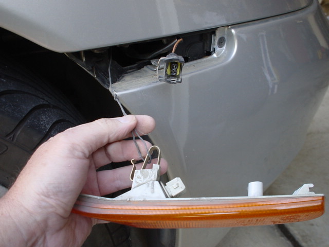

On my 2001 MY car the emergency release is definitely on the drivers side. I know because I've had the nose off, and re-routed the cable a little...

Right after I got my car I extended the release cable to the sidemarker, so I can never be locked out.
