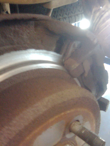

They feel like this at the moment ! (slight exaggeration possibly here)

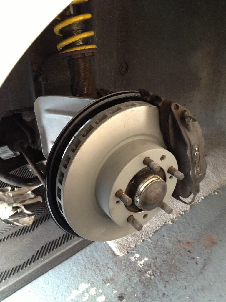

My Mintex M1144s arrived from Motorsport World today, 24 hour delivery and a phone call to check the order before they were sent out - very good service.
Slotted in no probs with a bit of copper grease on the back; the callers could do with being powder coated but they had a full service just over a year ago so it would be for cosmetic reasons only:
