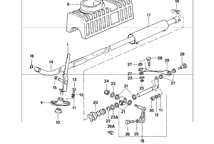

Also, try moving the gearbox selector rod in-and-out by hand (in the direction of the yellow arrow on your thumbnail).
Not very likely, but I guess it is possible that the selector rod biasing spring could have dropped a coil or two.

I'm also going to replace part 29, as there looks like there is some play.

In the picture below I have highlighted a shaft the comes out of the gearbox. It gives you front/back movement on the gearlever.
Problem is I can pull this out and push it in (as the arrow shows). All I can think is something that holds it inplace inside the box has come loose?
Any ideas?
That would be the selector rod I referred to in my last post.
You can access it by removing the three M6 screws (# 5) holding the retaining plate on. It should then be possible pull the selector out as a complete assembly (# 9).
Detailed inspection of the rod, lever and spring should give you some answers.

Also, I forgot to mention that you need to remove the associated indexing spring and plug (# 1,2,3 and 4) before you can withdraw the selector rod. Sorry [&o]

The mistake I made was the bolt that joins the short shift and the connecting rod (part 19), wasn't located in the dimple properly. At some point between fitting the short shift and the linkage (above) it has slipped, causing play. Once I realised and tightened it up all was well!
