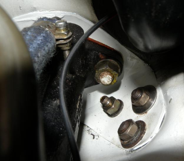

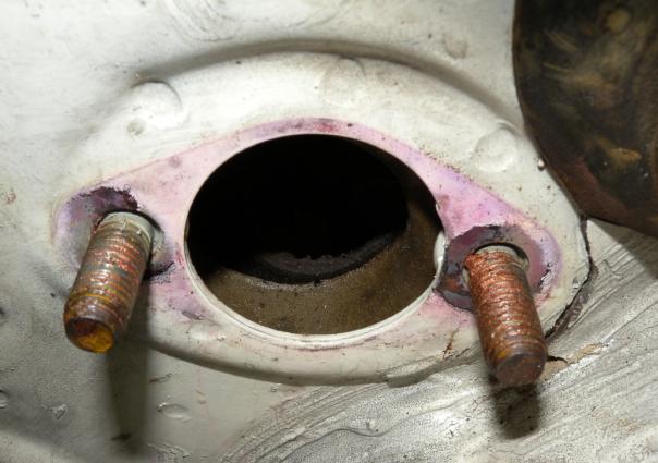

After 180k miles of good duty the firewall around the clutch master cylinder often gets tired and in my case the installation of a rather stiff pressure plate highlighted this issue as the clutch pedal didn't feel quite right when pressing it.
Some preventive action was needed to avoid the risk of being uncomfortably left stranded on the side of the road with a broken firewall.
