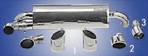

- Cargraphic Rear silencer with twin outlets (there is a Cargraphic plaque on the bottom of the silencer with product code: P64ET2 - is this the same as yours?) I've attached a piccie of Cargraphic's current system which looks like mine - although mine could be an earlier model.
- G-pipe (no secondary silencer)
- exhaust trims as number 2 on the pic.

Rich
I'll endevour to get the car on a ramp and take a picture of the system.. It may be the miltek bit of your system that makes the noise. My system is complete cargraphic inc the manifolds. I have no undertray and a drilled air box too but no issues with noise at Donnington for example.
