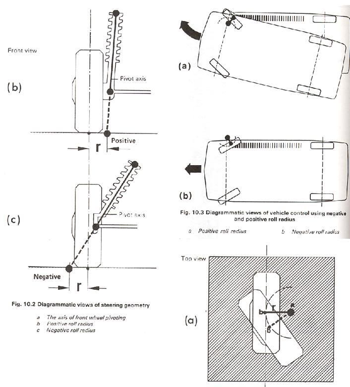

I think I may have stumbled across the reason why early cars feel more alive than late cars.I have often been told quite vocally on here that early cars feel more alive to drive than late cars ( remember pixie) The thing is could it be a simple as the set up of the front suspension and steering.Late cars are set up with negative roll radius steering i.e the king pin is inreased to allow the centre of the supension line to fall outside the centre line of the wheel. This makes the car alot more stable but less willing to turn in as sharply as cars without a negative roll radius. Hence the later cars feel a bit more ponderous in the steering and not as twitchy as the early cars .
Any of you track boys who know about suspension sets ups shed any light on my little theory?
