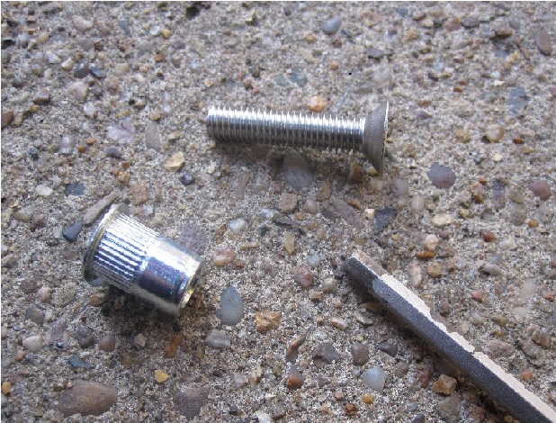

The M6 rivnuts arrived Saturday morning, and I managed to do one side. The spanner and nut method worked for me with no problems.
Door strap is now bolted on nice and tightly.
The only things I would be cautious of..
If the steel is quite thick get longer rivnuts, as the shorter ones might not work. And go for steel not aluminium. Ally might work fine but steel is obviously stronger.

The rivnuts were pretty standard length I think (14mm). On the link above it says they will work with a material thickness up to 4.2mm, and thinking about it that's plenty.
It was difficult to tell what the original bolts screwed into, I originally thought captive nuts, as no obvious nut on the lower hole (I assumed I drilled the whole nut out). But the top hole still had some kind of nut or plate behind. Eitehr way the rivnuts worked well :)
Its worth buying some M6 countersunk bolts too, as the originals are made from what I can only describe as chocolate.
