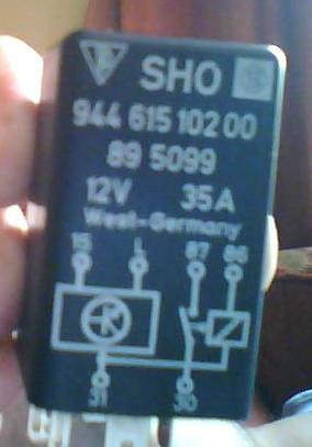

Wanted to check the dme relay having read the really helpful clarkes article and so have pulled mine out and first thing is that it is stated as manufacture 1984 so is pretty old
My biggest puzzle is that I do not have a 87b terminal on mine, I attach a pic below
can any one tell me on the basis that I need to connect 87b, 87 and 30 together which ones these are on my relay.I'm assuming 87 and 30 are the same just not sure which is the 87 b.

Well, I think I need to make a confession and say that I've been a right dick head !!
Being new to 944's I just pulled the nearest relay to me which from memory looked like the dme relay. If only I'd checked the manual first !! I took out completely the wrong one !
So having realised that mistake I took out the right one and could not check with the clarkes 3 wire method as I have an after market immobilsor which I think is connected in some way due to if the relay is removed I get nothing not even the starter motor cranking.
Anyway looked inside the relay, could not see any damage so put case back on gave it a flick and re-installed. I then have also taken out the fuel pump fuse made sure ends where OK, no damage and terminals in fuse block were ok and re-installed.
Hey presto - fired up instantly :) so don't know if fuse was dodgy or it is the dme but lesson learnt and new DME is ordered
